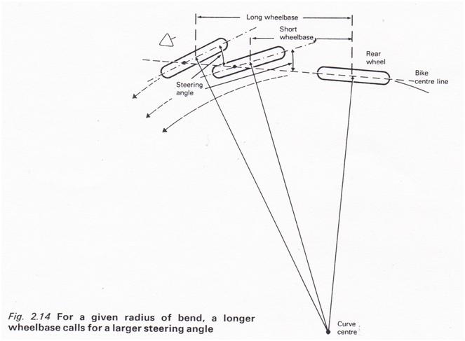

Wheelbase plays its part here too. Obviously a shorter wheelbase allows tighter turns, which in a sense means quicker steering. “The path’s radius (ie of a bike when cornering) is directly proportional to wheelbase” (V Cossalter, Motorcycle Dynamics)
Wheelbase effect.JPG (24.36 KiB) Viewed 25100 times
You can see in that diagram that a longer wheelbase requires a greater angle of steer for the same centre of curvature & the front wheel follows a larger radius of curvature (wider path).

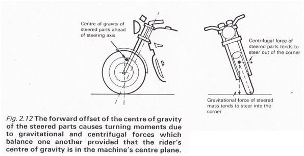

Apart from the self-centring effect usually associated with rake, it also has an opposing potentially destabilizing effect which can be considerable at rest &/or slow motion & therefore is more significant in trials.
We all know how, when you lean the bike to put it on the side-stand, the steering flops to a certain point of equilibrium (ie a certain angle of steer; see later why it stops there). This is a consequence of rake.
To visualize the connection to rake, consider an upright bike with zero rake (ie vertical steering axis). It does not matter how far you steer it, or how much trail you have, the headstock does not rise or fall. Now consider it with 90deg rake (horizontal steering axis). If you ‘steer’ the bars left or right the headstock falls considerably - by as much as the radius of the tyre/wheel at 90deg of ‘steer’. Hence it is rightly called head-drop.
All diagrams courtesy Tony Foale; used with permission (http://www.tonyfoale.com/book/)
The flip-side of this is that, at slow/no motion on a bike with typical rake & trail, the weight on the front of the bike wants to force the headstock down, steering the wheel in the process, especially when you start to lean. This is another undesirable state for trials as it can be quite noticeable at low speed & can upset balance or catch the rider unaware, even though friction slows it down somewhat at/near standstill. It is another reason for minimizing rake in trials.
It is added to by what we might call flopping-in. At low speed & with lean, the gravitation force of the weight of the steering mass acting down/inward through its C of G exceeds the minimal centrifugal force acting outwards & so produces a torque about the steering axis turning inwards.
Steering Mass C of G.JPG (27.66 KiB) Viewed 25038 times
So several things make this head-drop effect feel stronger - more weight on the front of the bike (laden & unladen), greater steering mass & more offset of its C of G. They don’t affect how far the headstock drops & the wheel steers (which are directly related to each other as we shall see), but do affect how strongly it is felt & the force required to raise the headstock again, ie to return steering to straight ahead. They are not the primary cause of head-drop; rake is, but they do exacerbate it.
Thus kicked out yokes (angular triple clamps) & forks with offset axle reduce how strongly this is felt to some degree because they reduce the offset of the steering mass C of G. But they don't address the fundamental cause - ie too much rake. Some rake is a benefit because, up to a point, rake gives you trail with little/no offset of the axle, so the offset of the steering mass C of G & the flop-in effect are minimized in such cases. So is steering inertia.
This head-drop effect is not necessarily all bad because if the geometry is right, it can help steer the bike into the corner ‘automatically’ – the self-steering effect - so that you can "steer with the footpegs". It's not the main self-steering effect though. That comes from trail as we’ll see later.

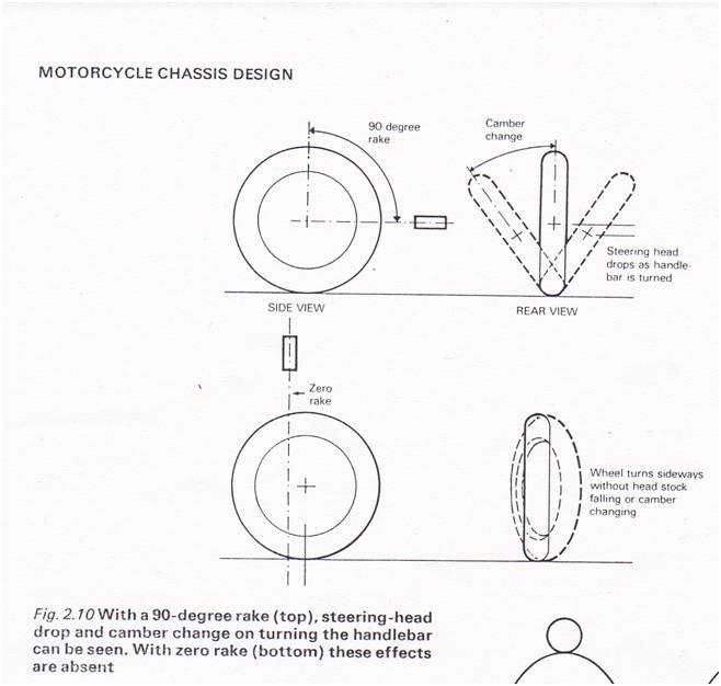

There is another problem with rake; perhaps the worst of all. As we have seen, when you turn the bars, rake transitions into camber so that at 90deg steer, a bike with 26deg rake (eg) would effectively now have 26deg camber & zero degree rake (in the direction it is steered). Worse still, whatever axle offset you started with now puts the tyre’s point of contact with the ground that far ahead of the steering axis.
Negative Trail.JPG (36.32 KiB) Viewed 24962 times
All diagrams courtesy Tony Foale; used with permission (http://www.tonyfoale.com/book/" onclick="window.open(this.href);return false;)
So positive trail has reduced to zero then turned into negative trail as you steered. Hardly ideal! You can feel this transition when riding as the front end wants to turn-in further or tuck-under when the trail goes negative.
If the bike had more trail the transition point (to negative trail) would be closer to 90deg steer where it’s less noticed. But if it had zero rake, the trail would remain constant no matter how far you steer the bars right or left.
So the steeper the rake the less this reduction in trail as you steer & the closer you get to 90deg steer before trail goes negative. Since trials bikes so often operate at extreme angles of steer, this is perhaps one of the foremost reasons for steeper rake on modern bikes. But it must be remembered that in designing for steeper rake, offset must also be adjusted so that you still have an appropriate amount of trail for the steeper rake. If you don't, tucking under will likely get worse because of insufficient trail.
It is possible at the design stage, by minimizing rake & optimizing trail, to ensure that trail does not go negative at any angle of steer. See Fig 3.9 below for a road bike (89mm trail, 61cm dia wheel). At a typical 27deg rake, trail reaches zero at 67deg of steer & beyond that, goes increasingly negative. But at 20deg rake it’s delayed till almost 80deg of steer. And by the look of it (if you extrapolate the graph) at 15deg, trail wouldn't go negative at all on this bike.
